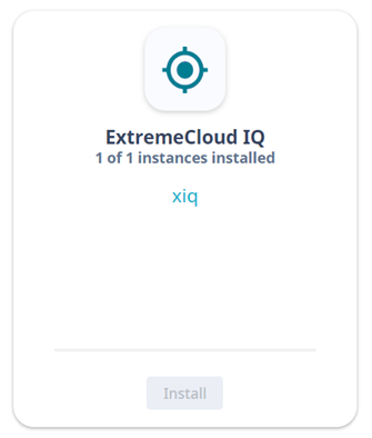

To install an engine instance:
  1. Go to Engines.
  2. From the ExtremeCloud IQ pane, select Install.
    After installation is complete, a confirmation notice is displayed and the XIQ instance displays.
Installed ExtremeCloud IQ Engine Instance
Installed ExtremeCloud IQ engine instance
